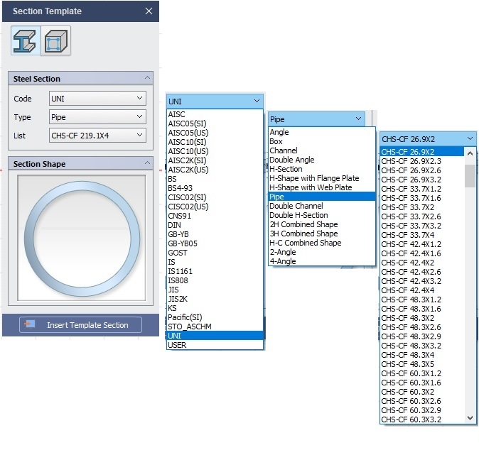

If it helps,
This is the menu for generating the structural profiles that I have on the calculation program that I use.
First, the reference standard is selected;
then the outline of the profile;
and finally the size;
Furthermore, I think it is not necessary to generate the preview of each section (IPE110, 120,...)
but an example would suffice (Ex. the first of each category)
Edit. I fixed the attached image
