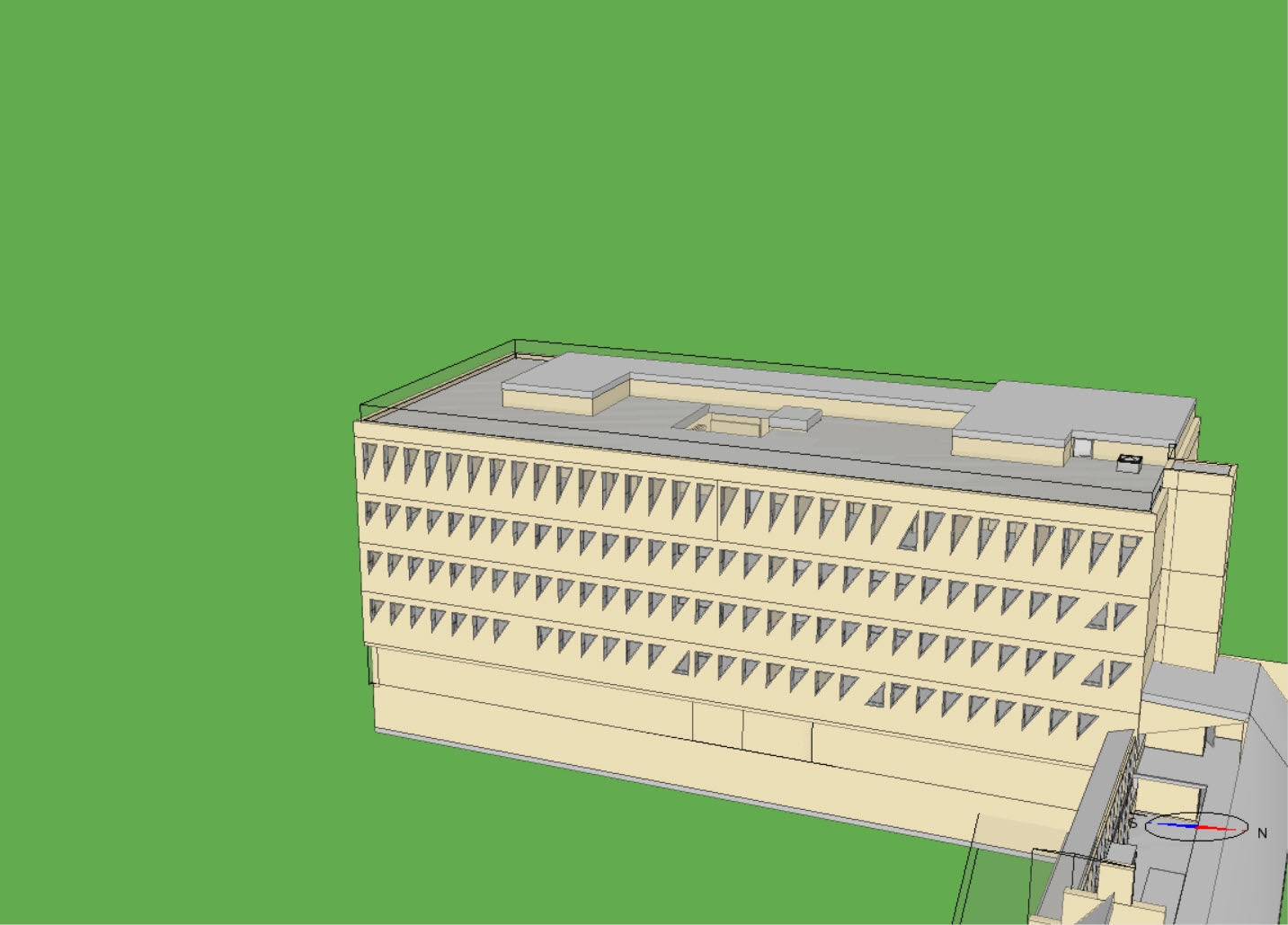

    At times we receive non functional IFC files for use in IDA ICE. There will be some surfaces which can not be imported, like the image under suggest. This causes me to not be able to start my environmental modeling as i then need a DWG file instead to model the needed geometry for the building.

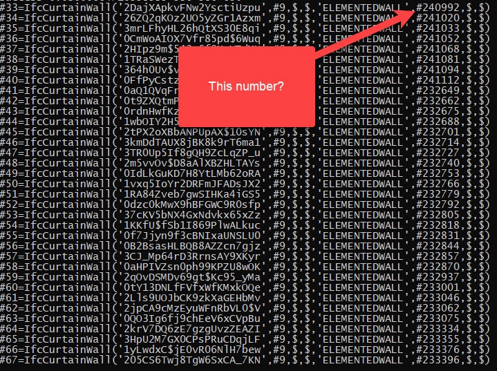

    Would it be these numbers i would have to put in the "[ ]" notation? If so, there is a lot of manual work here. i can not copy paste the console text, and my suggested workflow was to take the text into excel and manipulate the infor there, and then copy it into the [ ] notation
  4. A
    No, you'll need ids of the elements (#33, #34, #35), not some of their attributes.
    Why cannot copy the text from console - what system you're using?

    However when i study the objects which is in the list there is some xx numbers, xxx, xxxxx and xxxxxx numbers, meaning i can not generate with ease any list taking # 33, # 481, #98887 and #190505 as an example. Is there ny way to modify the script to just auto decide what numbers the failed elements are and place them in the [] list for failed_elements?

    It is possible to copy the text from the cmd on windows, there probably some option in the settings. Though I'm using Windows 11 and settings for cmd are a bit different here, so can't show you the exact setting. Then you'd be able to get ids from the beginning of each string either in excel or some text editor to create an arbitrary list like [33, 481, 98887].

    By some help from ayex in the chat yesterday i had assistance to where the missing copy function for the toggle system control was hiding. After some math magic in excel + notepad i got finaly the number sequens in the script provided by Andrej730. I am happy to share i succeeded deleting the inaccurate surface, made new IFC and had a successful import of the IFC into IDA ICE.
    Even if the window shape in the image underneath is not accurate, working in floor plan 2D mode i can still make the geometry for my needs, and also see where i can place out IDA ICE Windows. I hope this tread can be useful for more people, or with simelar needs when it comes to IFC Debug -> Test all shapes. :)
