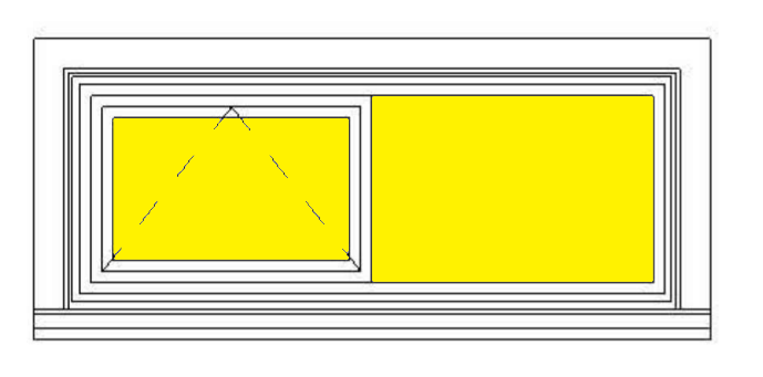

@Max are you looking for the glass area as opposed to the overall area of the opening in the wall? like the yellow bit in the window elevation. I was wondering about this for Passiv Haus calcs
Thanks @Nigel for the image, this is exactly what I am looking for.
