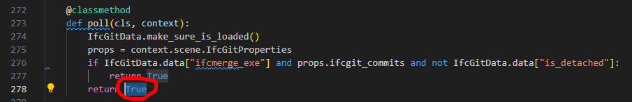

I switched that to true to just test...
Then tried to merge branch.
