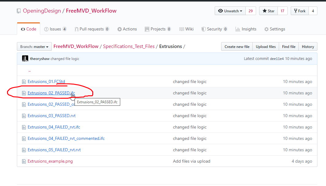

Anyone know ArchiCAD, IFC, & Github pretty well?
If so, any interest to roundtrip the file circled below? And then push the resultant .PLN and .IFC files?
https://github.com/OpeningDesign/FreeMVD_WorkFlow/tree/master/Specifications_Test_Files/Extrusions
We are testing how certain objects roundtrip through various BIM programs.

@archiiso What we are trying ATM is to test the above file(s) on different platforms to see if they give the expected results. You could try with 1) open the Extrusions_02_PASSED.ifc file in ArchiCAD (see the link @theoryshaw provided in the first post) and check that it looks like the reference image, and that the extrusions are editable and the rectangular base shapes too, and if yes, 2) save that file as .pln, and reexport it to IFC, try to open that new IFC file in an IFC viewer app like http://ifcquery.com and check that it all looks correct. If we get there, then it would be cool if you could create yourself a github account and upload both files to the above repo, we can explain you how to do that then.
