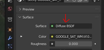

I am on a second journey trying to get aerial images right into FBX as material. For a flat image this works. But when a mesh is created using elavation , and sticky material is used, this fails to export with materials. How do i get this right? Any idea's welcome, i am lost in too many options :)

It's only possible to export very simple material setups to other formats. You can try to swap the diffuse BSDF to a principled BSDF ?
M
by magicalcloud_75 on 26 Apr 2022
It doesn't seem to have image as option
G
by Gorgious on 27 Apr 2022
If you click on the yellow dot on the left of the "Base Color" field, it should prompt you with "Image Texture" and you can then select your image texture file there

Awesome! Thanks very much!
This works now for our NL BlenderGIS AHN4 models.
